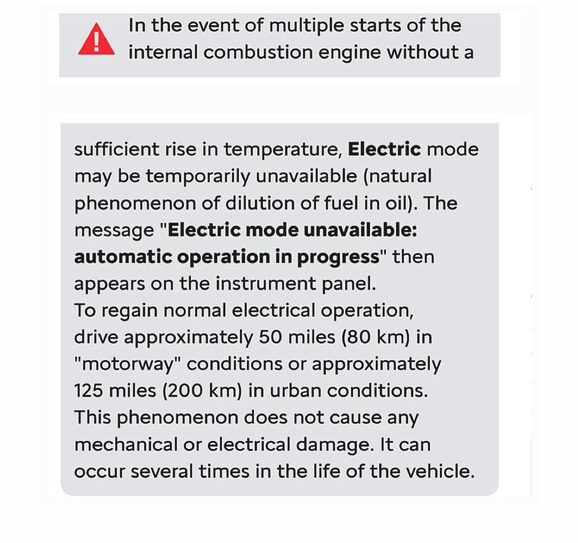

Have you tried manually charging your 12v batteries ?
If you read the manual it does mention that certain features may shut down if the car does low mileage.
My advice would be to charge the hybrid, charge the 12v main battery (this will trickle into the smaller 12v) and take the car for a nice long trip, hopefully you’ll see a difference in how the hybrid starts to behave.
If this doesnt work get your 12v batteries checked out, if one of them needs changing remember to check the terminal removal sequence before removing.
Remember though, as mentioned above, that even with a full hybrid charge, the car will still want you to run the engine for a certain amount of mileage , it needs this done to run its own checks and get the engine lubricated ect.

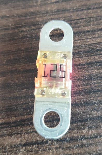

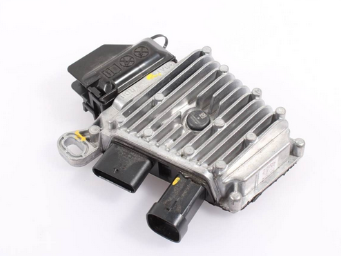

If it is not too late, I had the same issue in Peugeot 508. They share the same configuration. I suggest the following:
It was a blown fuse located directly next to LVNSD2 module, it is purple 125 Ampere fuse.
What to check first, before attempting the replacement of module:
  1. Make sure the fuse is not blown:
  1. Ensure the car battery in the trunk is properly charged. On started engine - about 13-14V
  2. Ensure the LVNSD2 module is properly connected on every end, + and - connectors as well
  3. If there are no issues with wiring around the module, the most probable issue is the module itself - replace it
Additional notes:
This module most likely does not require any learning/telecoding - it works from the start after replacement.
Backwards compatibility - you can replace it with the module of other date of production. What matters is the module name itself.
LVNSD2 belongs to the rear car battery
LVNSD1 belongs to the front car battery
I am not sure where is the rear car battery located in DS4 exactly,

There are two LVNSD modules:
a) LVNSD1 module applies to the front/main car battery
b) LVNSD2 module applies to the rear/secondary car battery
These modules read specific data that apply both on the AC Inverter (located in the front, above the gearbox), and the OBC DC/DC converter located left, behind the rear wheels (This is in case of Peugeot, but I assume DS has similar or identical location). Lastly, these modules read data from their respective car batteries.
  • If one of the modules fails in some way, it is most likely that the system stops charging one of the batteries. The module may not necessarily send an error code.
  • How the communications work is some magic to me, because after fixing LVNSD2 issues, also Airbag issues (pedestrian collision detection system) and cruise control (RADAR module) have stopped. To my knowledge, these modules should not be responsible for the mentioned systems.
Coming closer to your specific issue:
  • I would check if the LVNSD1 module is not providing any issues. I would check if LVNSD1 can be programmed/telecoded (Diagbox). If it failed to do so, I would replace it.
  • Make sure both the AC inverter and DC/DC Converter provide correct readings. DC/DC converter sends separate error codes that are not directly related to the problem mentioned in this subject. I am aware of what DC/DC should provide specifically, but this is a broader subject and would quickly go off-topic; creating multiple paragraphs on the issue. If you are personally attempting to solve the issue, I will provide more information.
  • If the rear battery is also not charging properly, this is an LVNSD2 module issue. Check for a 125-ampere fuse directly connected to the said module. If it is fine, attempt to program/telecode the module. If that fails, replacement of the device will be necessary.
  • If both batteries are failing to charge, this is most likely related to the OBC DC/DC converter.
