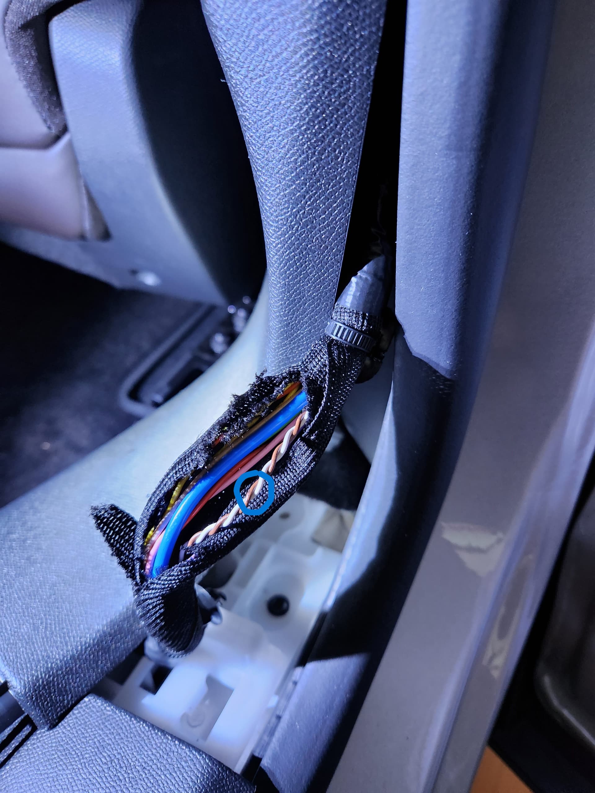

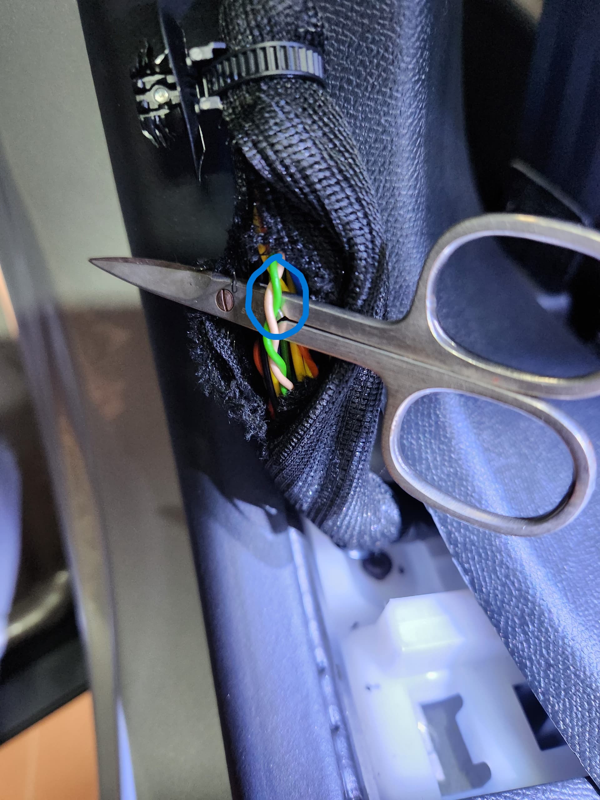

Hello, I own a ds4 Opera e-tense from 2023, but unfortunately without a focal system. I would like to install an active subwoofer under the seat to improve acoustics. I should connect to the rear speakers, without disassembling the door panels intercepting the wires that pass under the rear sill. It would be enough for me to know with certainty the right color and polarity of these wires. I hope someone can help me, it would be appreciated.
I am attaching 2 photos of the intercepted wires under the sill of the rear doors.
Unfortunately I think they are not the right ones.
