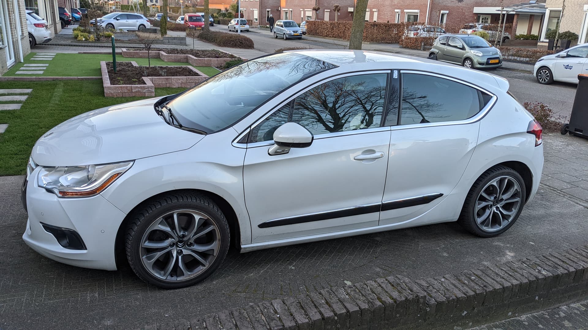

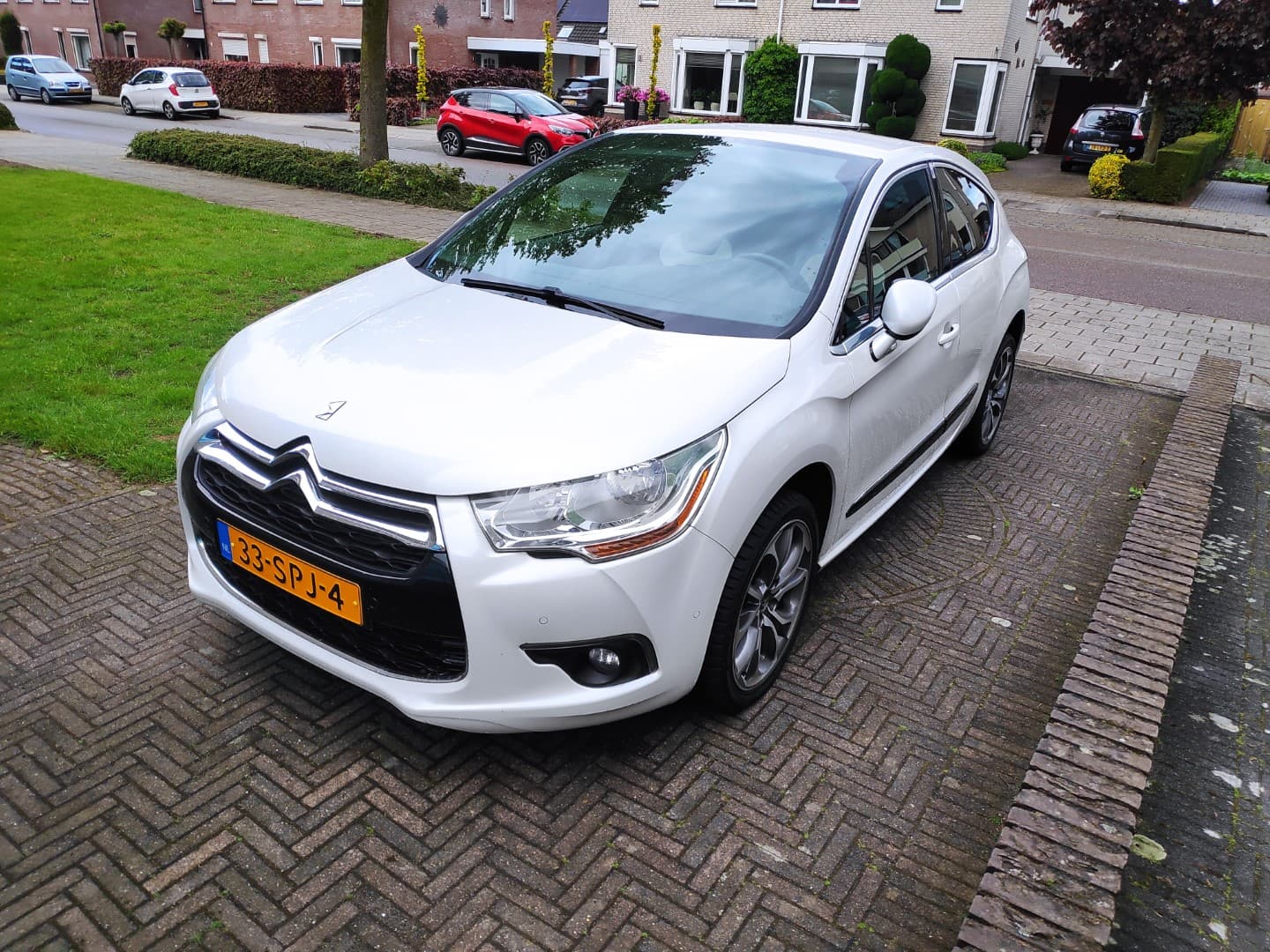

RandY's Citroën DS4 thp 200 Sport Chic
This my 2011 Citroën DS4 thp 200 sport Chic

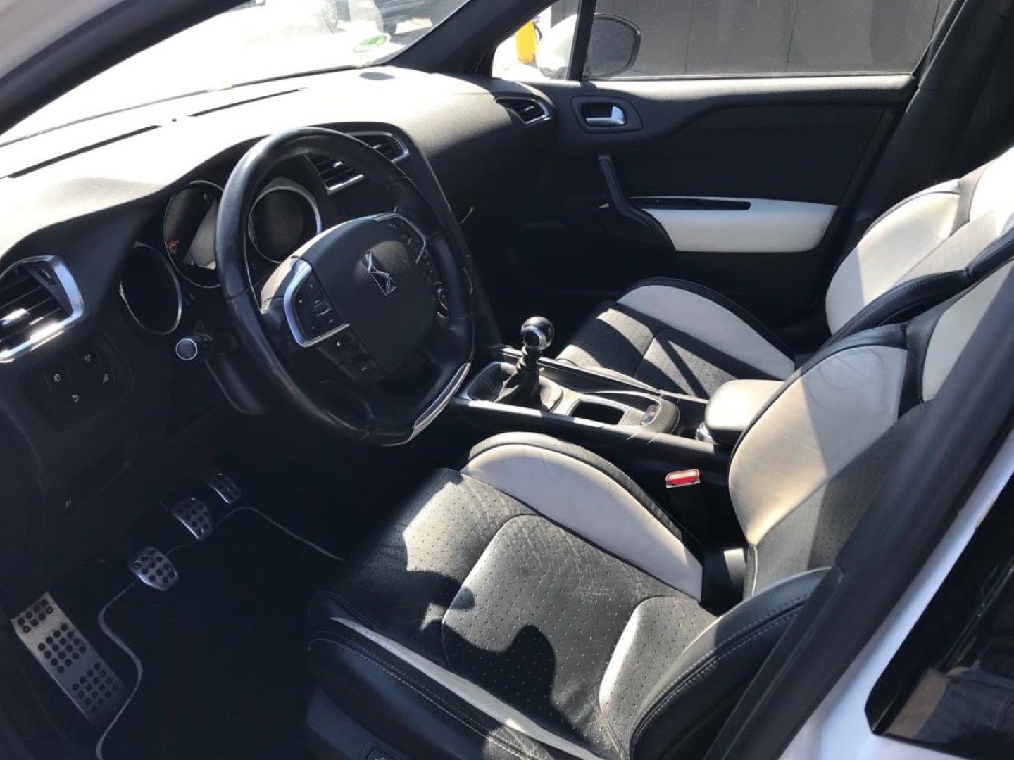

Black and white leather seats
Massage seats
Denon sat nav audio system with subwoofer

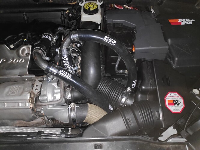

New turbo
Go fast bits DV+
Oil catch can
Replaced cylinder head cover (pcv valve broken)

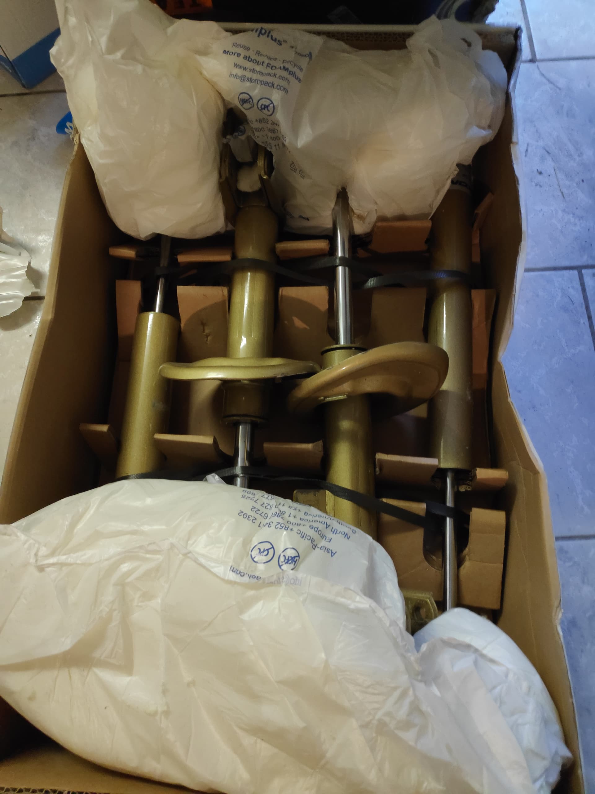

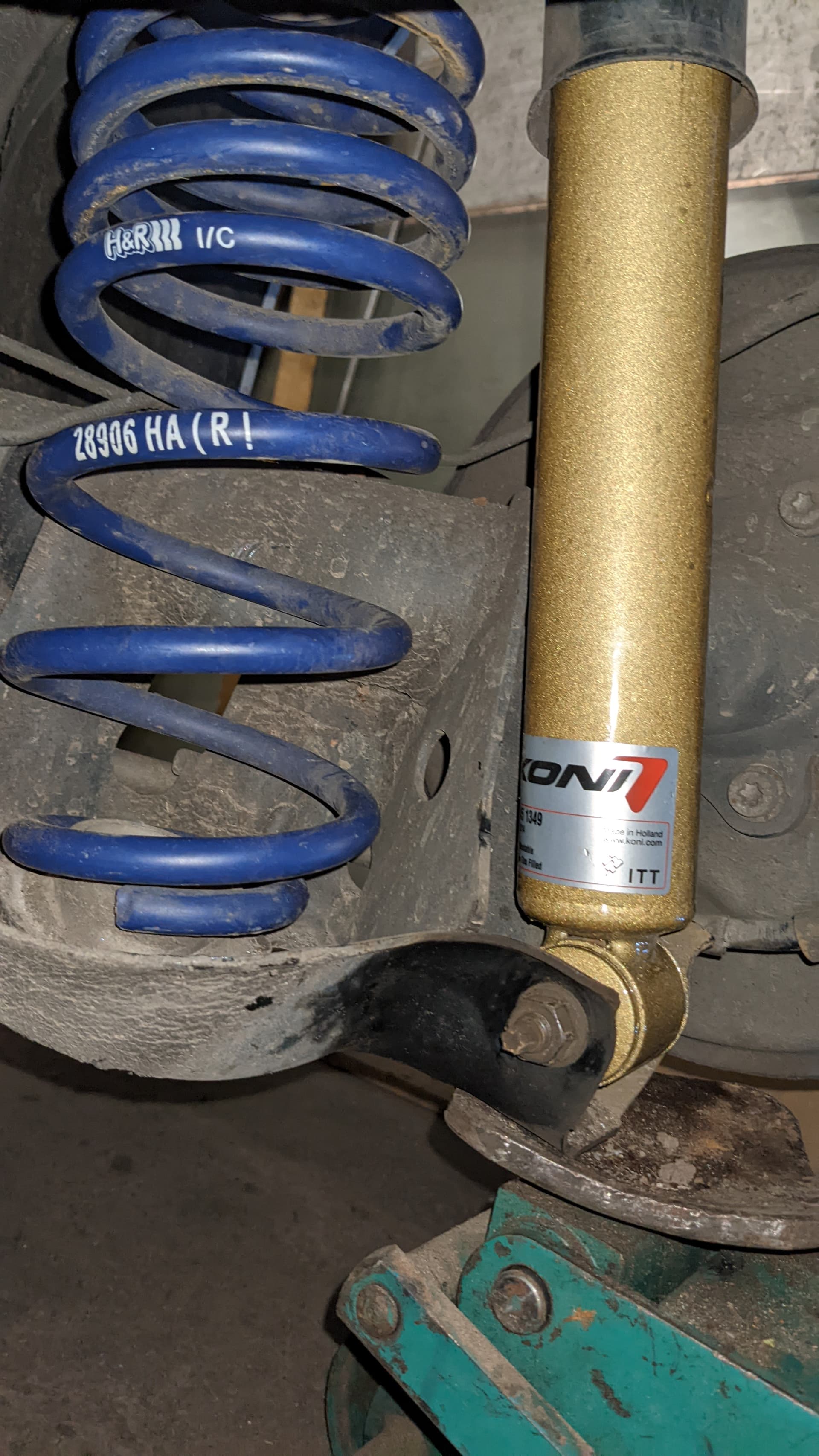

Place the H&R -40mm lowering springs with Koni FSD shocks.

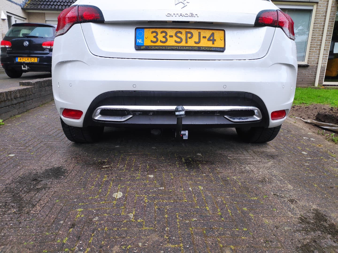

detachable towbar.
black and white interior

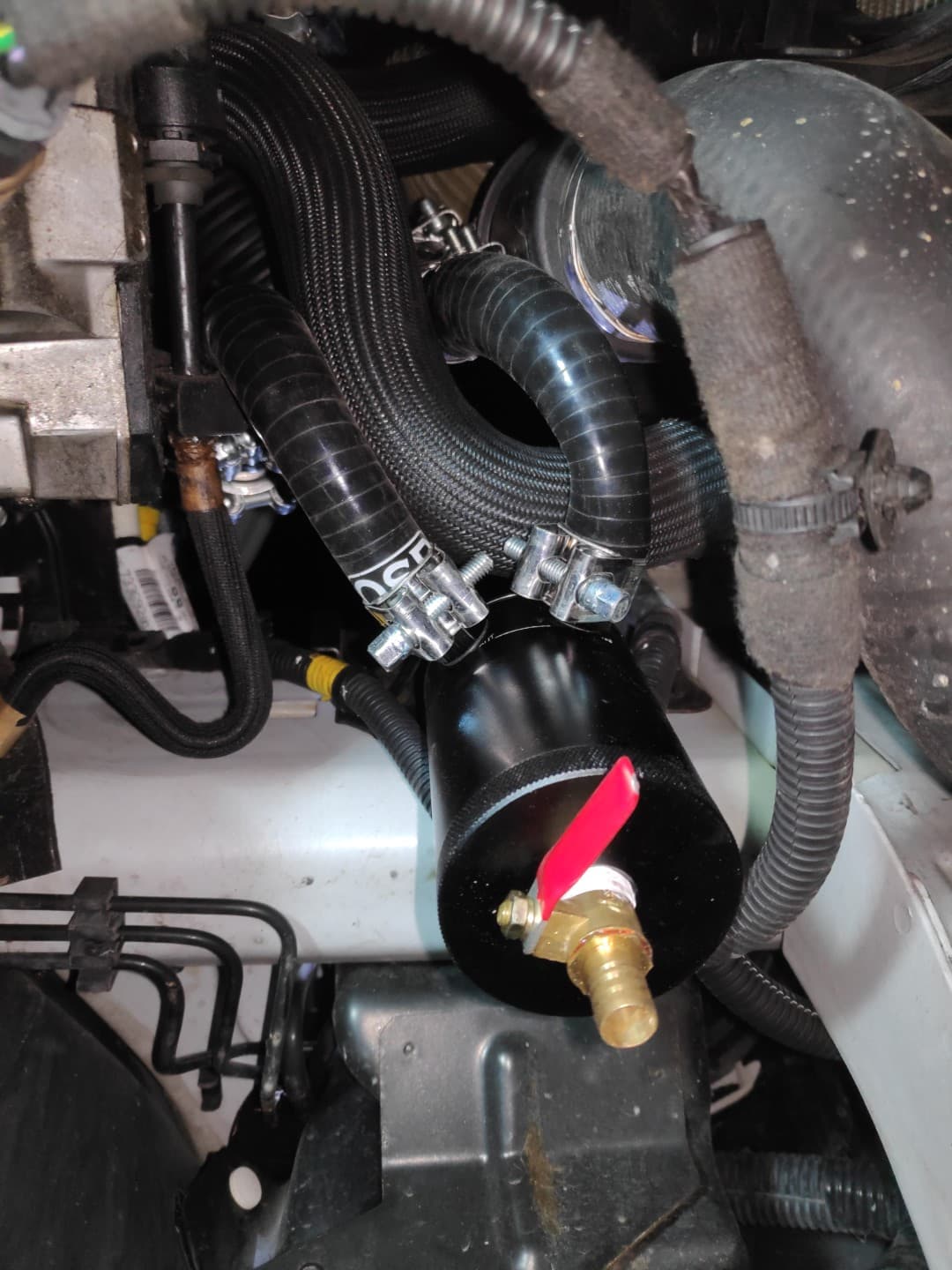

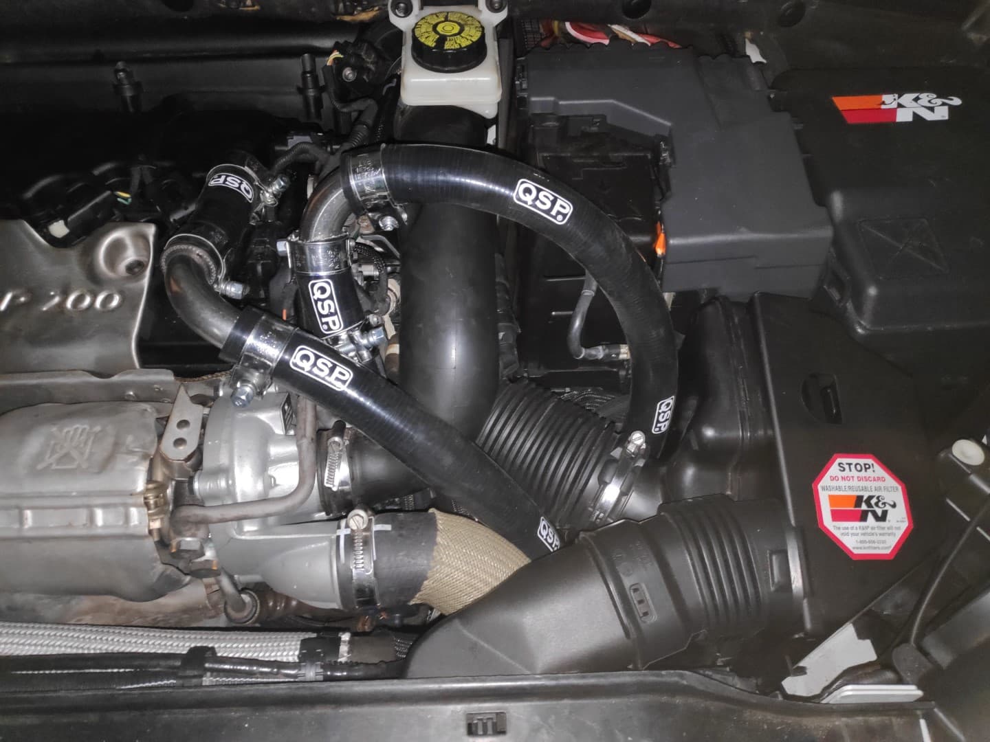

OIl catch can modification:
TO do: place the new koni shock an d H&R springs.

I love the B & W interior.

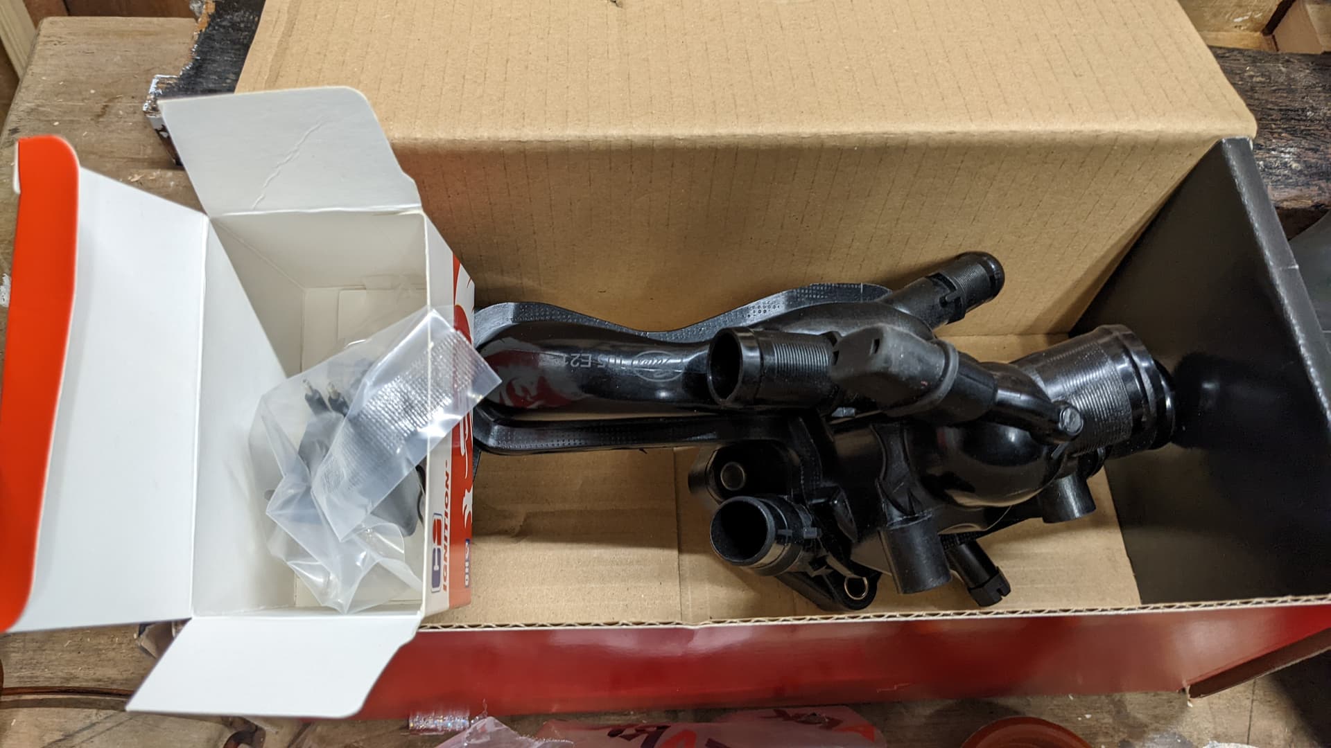

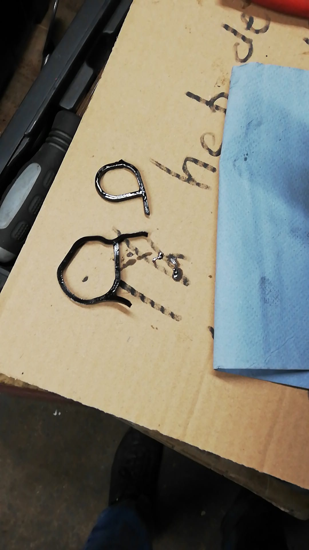

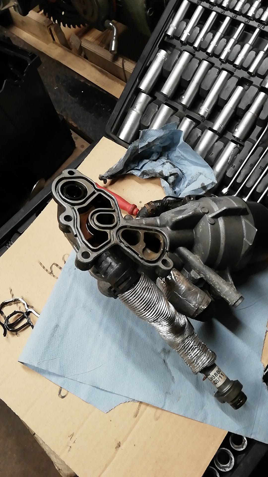

My brother helped me with the replacemet of the leaky thermotathousing.
We also found a small oil leak. So we replaced the gasket of the oil cooler

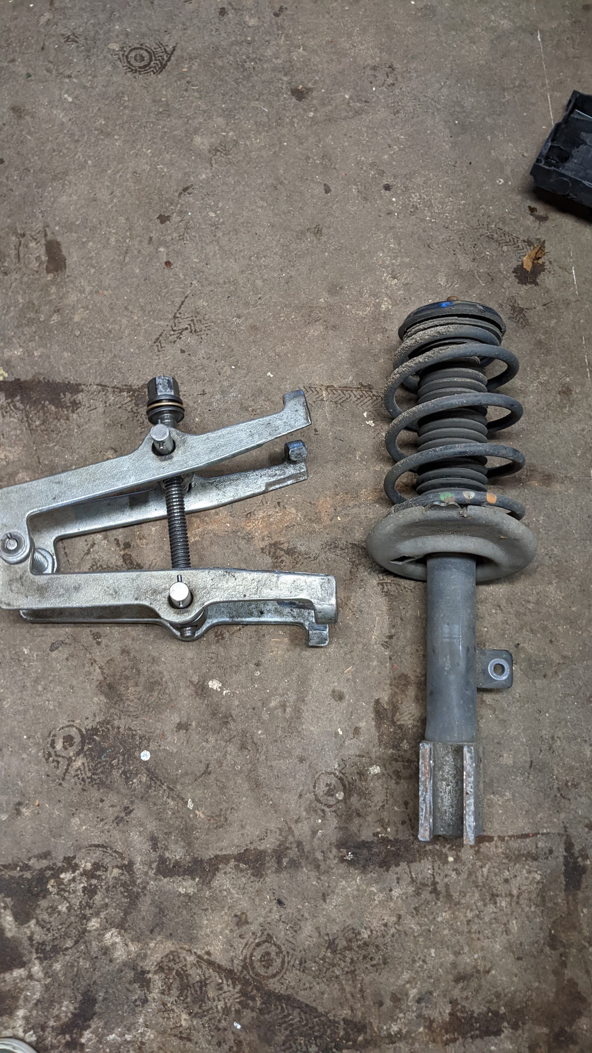

While my brother was busy with the engine. I started with the repacement of the springs, shocks and front top top mounts.
With this as result: :sunglasses: -40mm
The ride is much better now. Little bit stiffer, but more comfortable. Also the car dosn’t roll in fast corners.
So now i have a great suspesion setup, no coolant leaks and no oil leak. Time to enjoy the car
