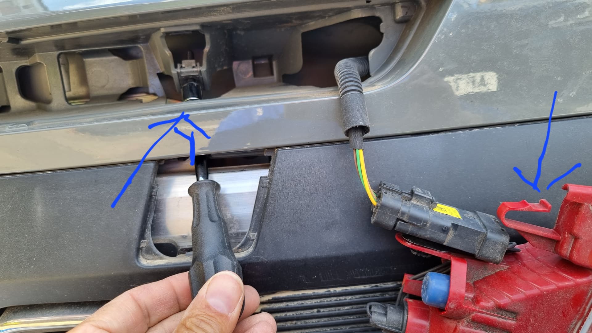

I’d be grateful for information about how to remove and replace the rear lower (left) light cluster. I cant find any videos on the subject.
I found the anwer myself.
Prise out the square plastic cover just above the tail pipe. Direct a 10mm socket or a no 30 torx at a steep angle upwards until you locate a bolt head/torx. There is even a black plastic guide to help with the angle. Loosen and from under the car release the red plastic sprung clip.
Thanks man! You saved me a lot of head ache.
Thanks bro you a real one. I bought a long torx 30 and got it replaced quite easily.
