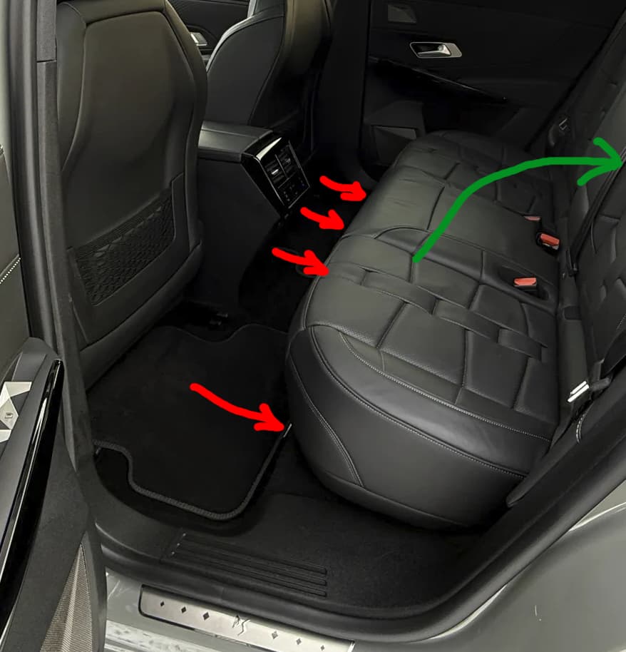

I think you need to unscrew 4 screws (red) that are hidden under the plastic caps then you can lift the seat (green)
Very similar to our Renault Captur.
On the Captur after removing the screws/brackets you still need to give it a good pull.

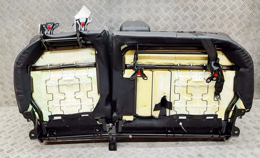

In the picture showing the underside, it seems the tube the runs along the back has a bracket. I can see a bracket like this in mine as well, which is bolted to the body. Perhaps I need to unbolt that. I’ll try doing that.
There are six additional screws, which also hold the seat back.
The type of seat mounts may depend on the interior trim standard. The photo shows the leather with adjustable seat bottom.
