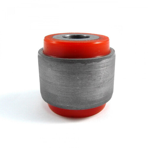

Perhaps some polyurethane bushings in lower trailing arms would solve this problem for longer?
One polyurethan bushing (rear one, two needed) for lower trailing arm is present here:
Number of the front one is 5131.C4 or 9801049980. But there is no polyurethane version.
