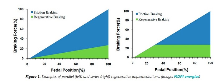

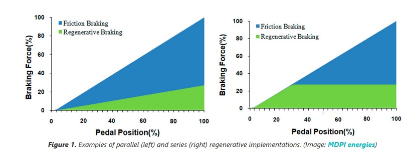

If a bit more detail is useful: Having done a bit on automotive control as part of my job, I was curious to better understand about how the regen braking works.
Google advised that the DS4 regen braking is “series” - which basically means that the first bit of braking action from pressing the pedal is entirely done by the motors (acting as generator) but as you press the pedal further the regen cannot deliver all the braking and so the mechanical/friction brakes start being used. So if you are very light on your brakes, then the friction brakes wont get used at all.
If you like graphs - series regen braking is the graph on the right:
The B mode just means there is extra regen, and even when the brake pedal is not pressed.

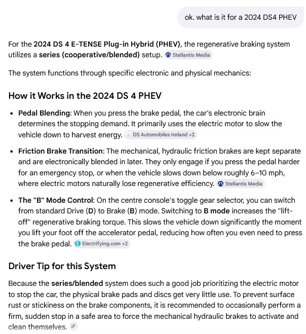

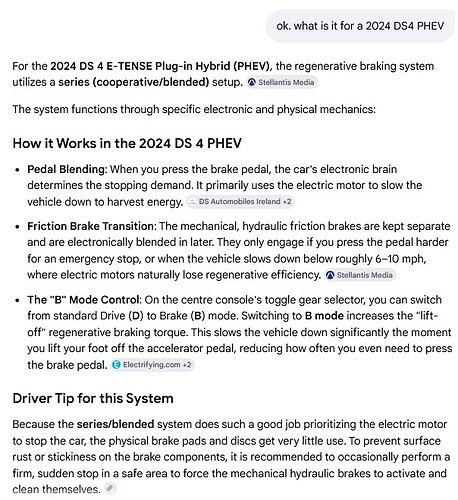

This from Google AI explains a bit better - though my experience is that such AI responses may not have all details correct. This seems ok.
