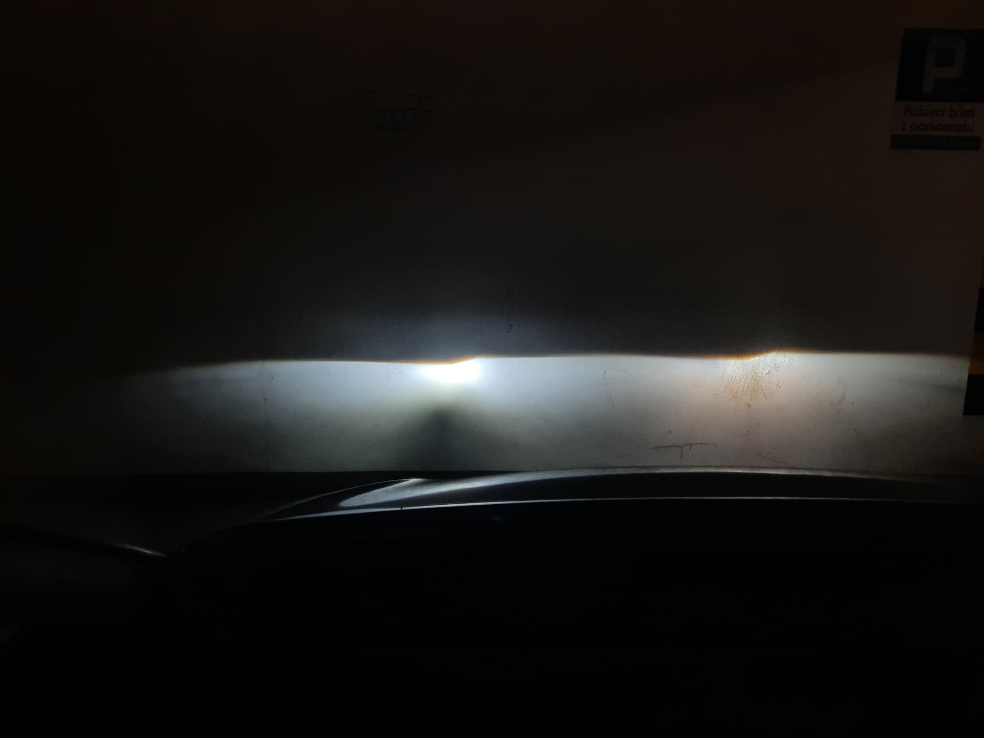

You have a xenon D5S 25W so you can try this D5S 35-45W led instead xenon Dualvision D1S LED-Scheinwerfer HID D3S D2S D4S D4R D8S D1R D2R D3R Turbo LED 30000LM CSP-Chip 6000K Weiß 4300K 70W 90W Plug&Play - AliExpress 34
You should choose 6000K, D5S with canbus (right photo)
I’ve been using them for two years in my C4 Picasso II and they are very good. Light quality is comparable or slightly better than xenon.
On foto left side led, right side xenon
