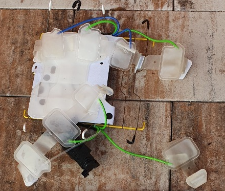

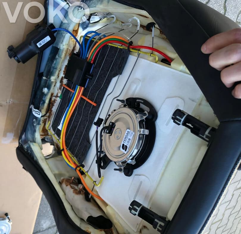

Unfortunately, you’ll need to remove the seat upholstery to access the pneumatic system tubes. One of them is probably damaged. Colored tubes it’s pneumatic masage system.
At the end of each tube is a small cushion that inflates and deflates during the massage. These cushions can also be damaged.
