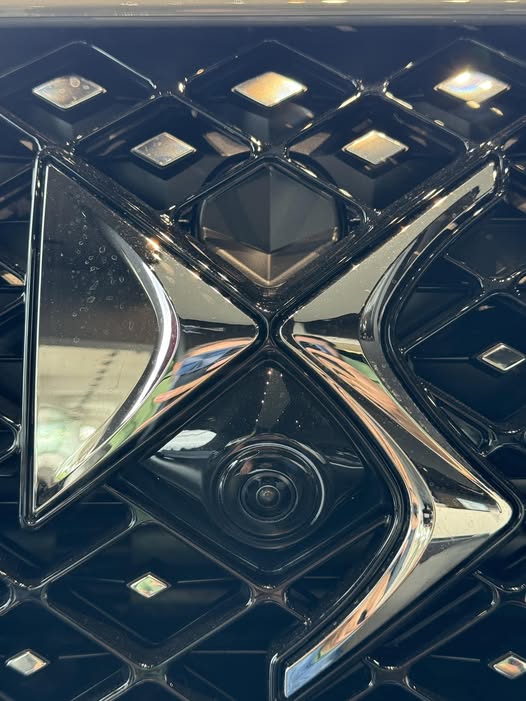

add front camera to a DS7 2024

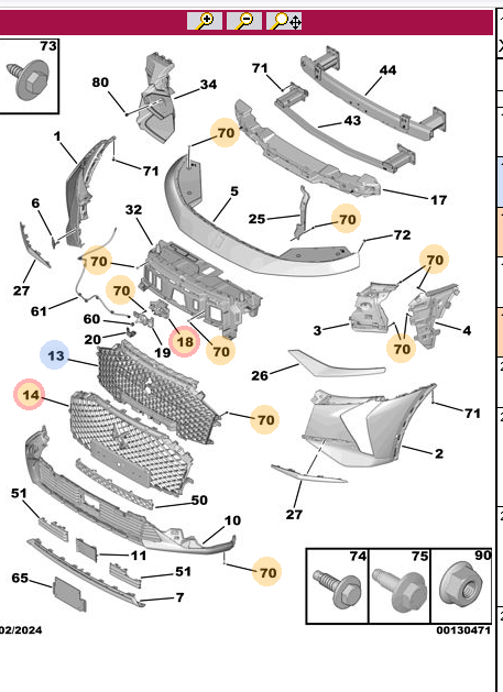

what do you need (the hardware parts)
front grille with the hole for camera
pn 98419790 xt o xm
camera plastic bracket
9841687280
front camera, I found a lot of codes-- they all look similar.
9847393680 ; 9847393680 01; 9832294580; 9822745380; 9832563180
first question : is there a camera resolution difference between 2019 an restyle 2022?
are these camera one equal to the other?
other little part to add to the bracket
9844855280
does anybody have a picture of this part??
