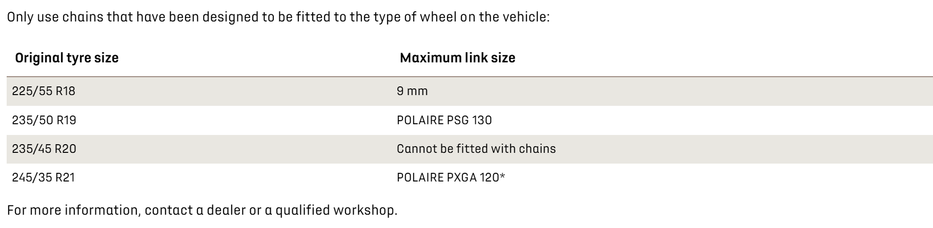

Does anybody have experience with fitting Snow Chains on the DS7 (facelift)? The instruction books mentions that Snowchains are not supported in 235/50/R19, but maybe that is refering to the traditional chains?
Of so, which type did you use?

You need to check the clearance between the tire/rim and the suspension components. There might be so little space that snow chains won’t fit.
If there is plenty of room (3–4 cm or more), any chain will fit.
Personally, I use snow socks. They’re much easier to install, and they don’t cause you any hassle when driving on snow.
I agree with the easier fitting, but Snow Socks are not allowed in Austria as a replacement for chains.
@Andrew_PL Makes sense, however if DS puts in in their instruction manual it feels a bit off to just go ahead and fit chains…
