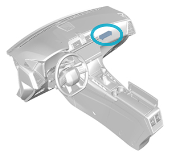

Yes, it sounds like the back-up battery requires replacement.
It is located in the dashboard area. If your car is under warranty, they should be able to do it for free for you. If not, the instructions are below.
Instructions for pre-face-lift model independant telematic unit:
| Left-Hand Drive | Right-Hand Drive (UK) | |||
| Removing Trim Only panel #3 needs to be removed. |
Instructions | Instructions | ||
| Removing Telematics Box/Battery | Instructions | Instructions | ||
| Battery | The battery part number may differ. Please check the part number on the battery you remove. Either 1609653580 or 1684919480. |
