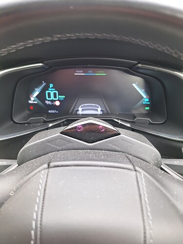

The “Be vigilant” command could be because you are wearing sunglasses, the more sensible half of this relationship gets them all the time when she is wearing hers. Or wipe the camera lens which is just above the centre of the steering wheel boss. Cruise control as other have said is either a dirty camera or their is lots of rain/spray, plus (from experience) make sure you are pressing the right button to initiate it rather than the resume button.

I cant see a camera above the steering wheel. Could you send a pic?
