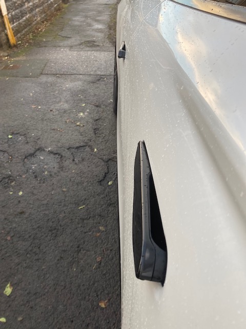

This is how both passenger handles are currently functioning in the locked and unlocked position.
They are sticking in the mid position.
Also lately, the drivers handle does fully pop out and fully retract, when unlocking and locking, but on occasion even in the fully open position the door does not unlock and needs to be opened by leaning across from the passenger side and pulling on the internal handle.
This issue with the drivers door is more frequent if the outside temp is cold.
But the issue with the passenger doors, as seen in the photo, is there no matter if the weather is cold or not.
You can see that the wrapping on the handle does not interfere with the opening or closing of the handle as the wrapping only covers the external surface of the handle and does not pinch at all with the body of the door or handle mechanism.

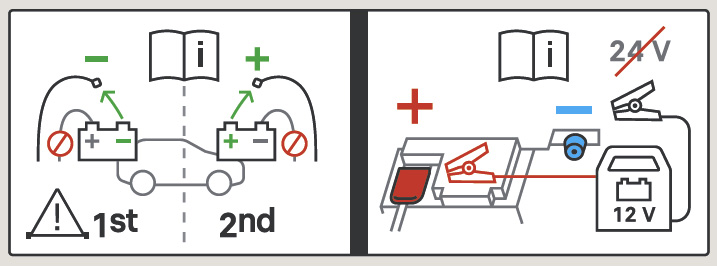

Now, when I wrap my door handles, Iāll definitely disconnect both 12V batteries. Just in case.
Just in case, what sequence would you disconnect the two batteries ?
And what will this do in regards to the cars settings, ie: will anything be lost ?
Start with negative under the armrest and then the positive in engine compartment.
Both has quick connectors - seems like the French new this was going to happen on a regular basis
You will loose date and time (my car at least) everything else is remembered.
