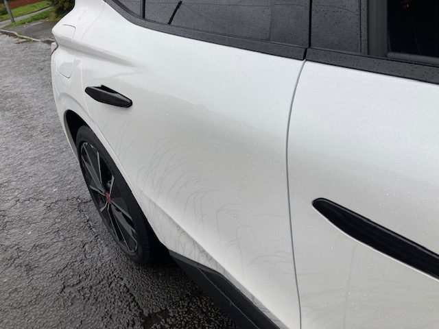

Thats the rear drivers side stuck in the open position.
Its a mechanical issue I believe ?
The one in the photo was changed under warranty a couple of months ago.
Now the passenger door is stuck in the closed position, sometimes it does function ok, but when it dont work it’s either stuck in or out or half in & half out.

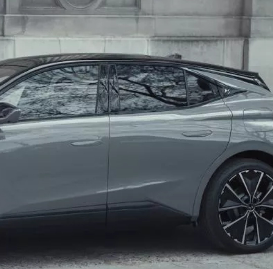

There were also versions with body-colored door handles.
I’ve never seen it in real.

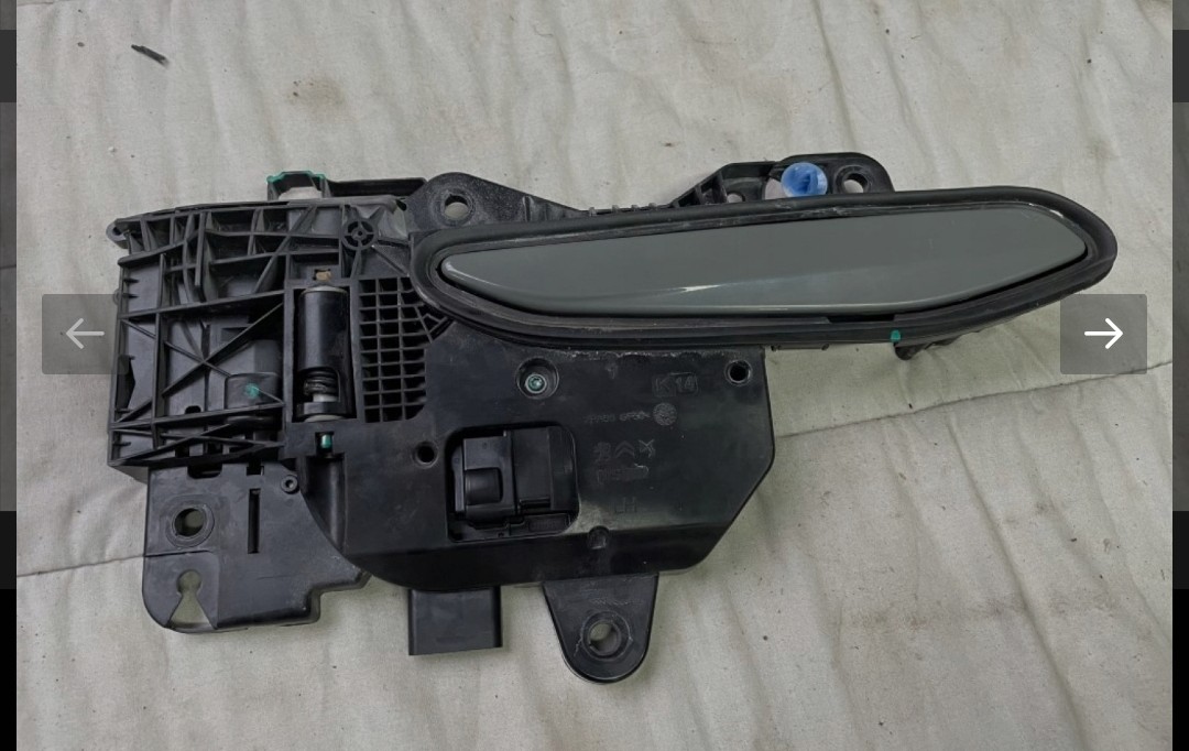

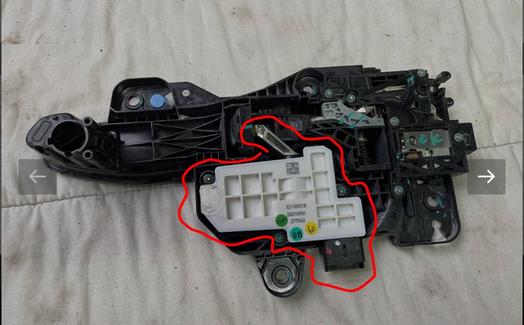

This is what it looks like after removal. Here it’s gray instead of chrome. And it’s not wrapped but painted.
The red marked electrical part that extends the handle.

So many plastics… Its probably some plastic in mechanism goes bad due to wear or outdoor conditions making it unable to work properly. This handle being used on DS3 Crossbacks as well. I wonder if they are having the same problem.

Unfortunately though, they sort of confirm that the whole handle and mechanism come as a sealed one piece unit.
I dont think its something that can be lubricated/oiled ect.
Once exposed does the unit come out from the rear of the door or out through the outside of the door ?
