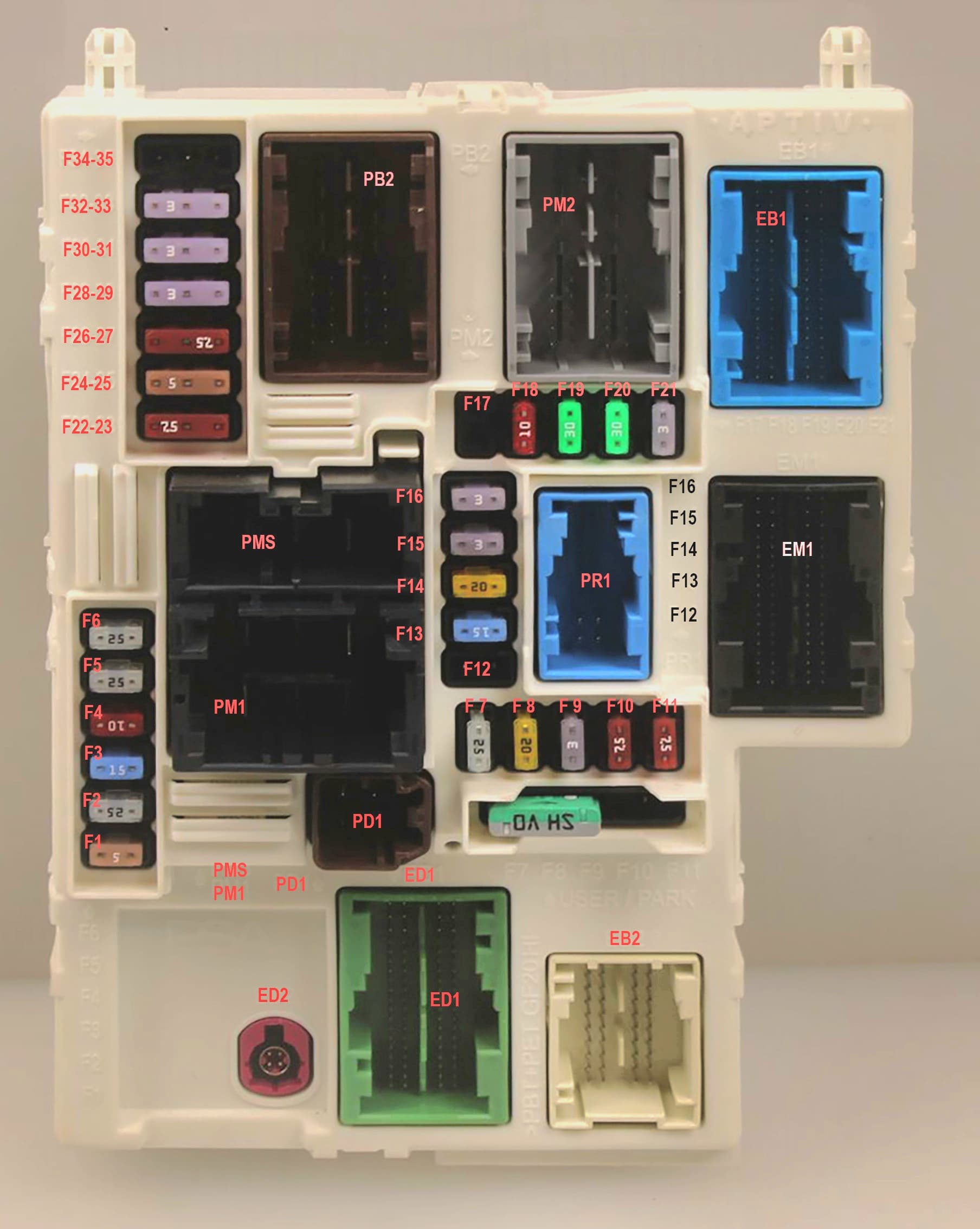

Hello guys so my glovebox light does’t work nor sunvisor lights, roof lights works and every other light work but glovebox and sunvisor lights doesn’t.
I checked fusebox and checked 2 5amps fuses but they was altight, I checked f24-25 I belive it was, and also checked F1 5A fuse.
I just cant get my hands with a multimeter there, I barelly checked those 2 fuses, anyone got a diagram? Or can help me find the fuse of those lights? I would much apreciate it
It’s passenger glovebox lighting - USB port 4 (USB charging port, row 1) - Center glovebox lighting
It’s the fuse for the rear exterior lights.
No data available.
Check:
F4 - Front Left and Right Reader - Rear Right and Left Reader
or F14 Front 12V Socket
