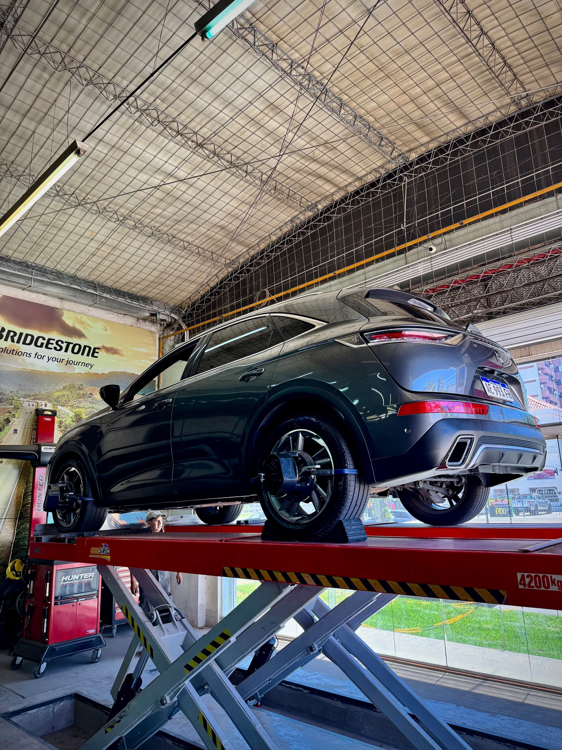

Ok, guys. Thank you for your help. The car is now aligned and feels smoother on the road. I haven’t driven it much and will further test it in the next few days. Convergence was set to minimum, in the green. Checked all bushes and joints, very solid all around.

OK, guys. Big update on this issue. The car still felt wrong after alignment, so I decided to call a proper mechanic, one with experience in sophisticated suspension systems. The official service and everyone else said “all is good”. Well, it wasn’t. At 54.000kms, my 4 active shock absorbers were completely dead, alongside all of the control arm bushes. After further inspection, they found all the electronic valves from the Active Scan faulty, main reason for not sensing any differences in the drive modes. A total nightmare, and it got even worse after receiving the quote for 4 new original shock absorbers, which needed to be imported, at a whopping $4500usd, plus bushes, rounding $5000usd all around, labor cost excluded. So, I had two options, either change every component or repair the shock absorbers with a specialist. After consideration and advice from my mechanic, who has several DS7 clients with the same issues, I decided to repair and refurbish the shocks, increase the stiffness and maintain the active scan fully operational. All for about 50% or less money. The job was completed in a week’s time and I’ve done over 1000kms with the new setup. The result was excellent. The car no longer bounces around, it is slightly stiffer - especially the rear, and handles 100% better. The drive modes change the character significantly, and Sport Mode gives you the confidence needed at higher speeds. However, it was noted by the mechanic that the electronic valves on the shock absorbers can break anytime under stress, they seem to be designed for European roads, and a bad bump can leave them open, resulting in insufficient damping, for good. The valves were reinforced, the shock absorbers too, with stronger internals and almost double the load, with a stiffer ride as a result. I feel some relief, but with a bittersweet feeling. How can a car with 54.000kms have these types of issues? Issues that are overly complicated and expensive to fix. The shop that quoted the original replacement shock absorbers was fully aware of the situation, and said they get calls every week from DS7 owners with faulty active scan suspensions. In comparison, my second car is a BMW 5 Series, and my wife drives a VW Suv, never a big issue, only minor things that were mostly covered by the dealership. A big disappointment from DS, and as I stated on my first post, I regret getting myself into this mess…I should have stayed with the germans.
