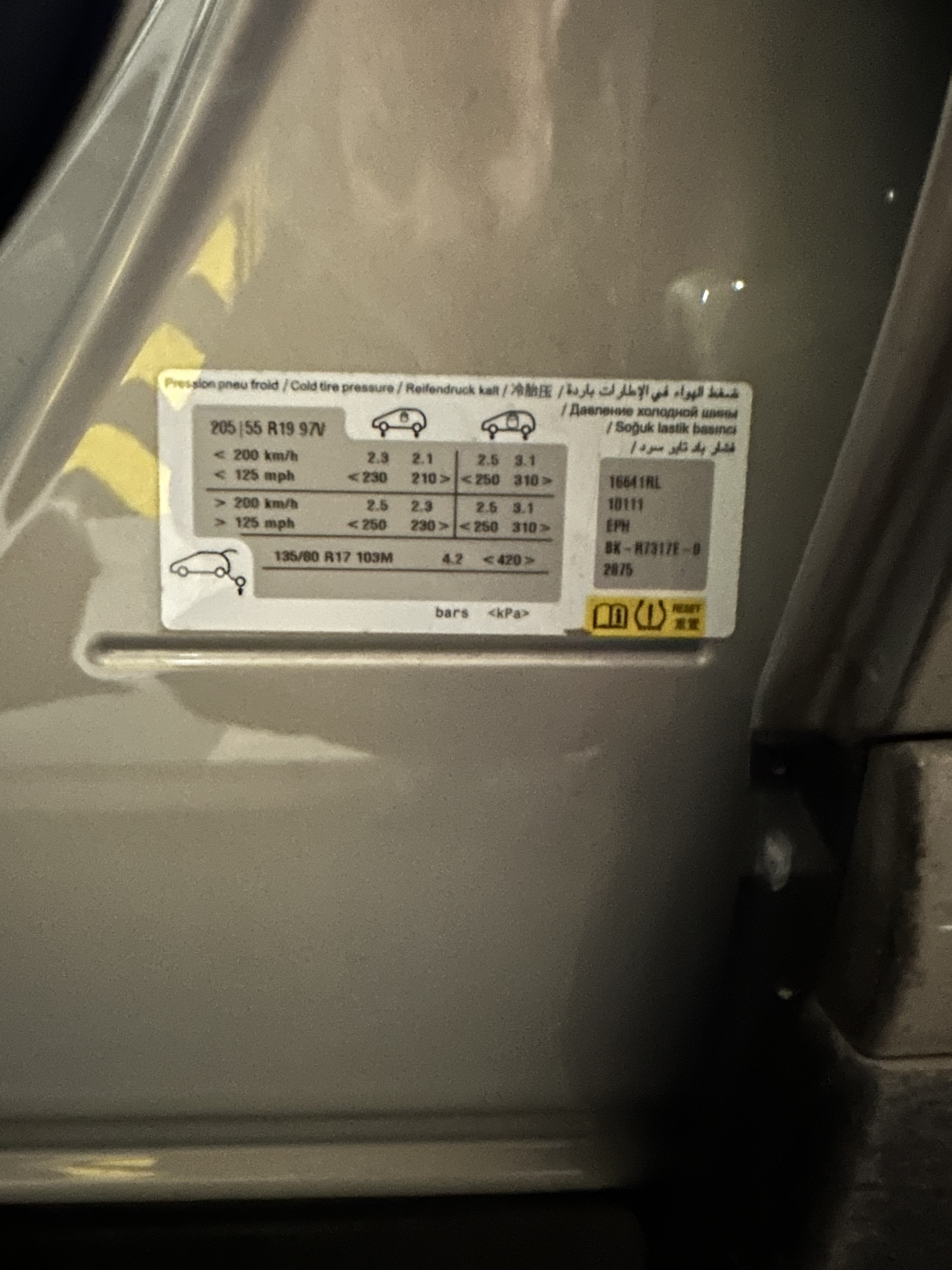

Does anybody have a tire sticker photo on the driver’s side for these twenties?
Not sure what you mean ?
Do you mean the tyre pressure guide sticker found on the door frame ?

Yes, this is what I need. I couldn’t find on internet that sticker what is the pressure above and under 200 Kmh without and under the weight.

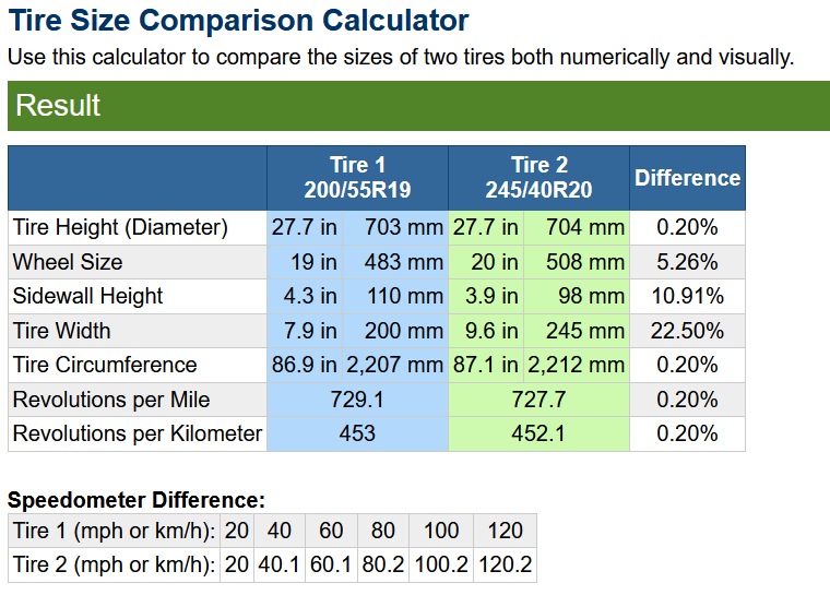

You wouldn’t.
The circumference would be 2,207mm vs 2,212mm, so only 0,2 % difference.

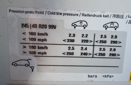

I have those wheels, I’ll pop a picture on today sometime.

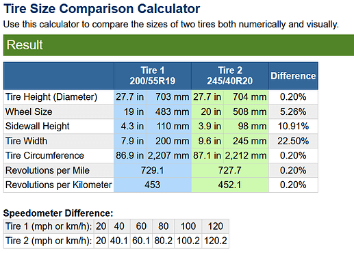

If you increase the rim size, you also need to decrease the profile in order to keep the circumference. If you don’t, you’d have to re-calibrate like you suggested.
You can use a tire size calculator to see how much difference there would be between different rim and tire sizes.
Here I put in the sizes that Zirna asked about:
As you can see, the speedo shows 0,2 km/h higher at 100km/h, which is completely negligible.
I didnt take into account the decrease in tyre size.
