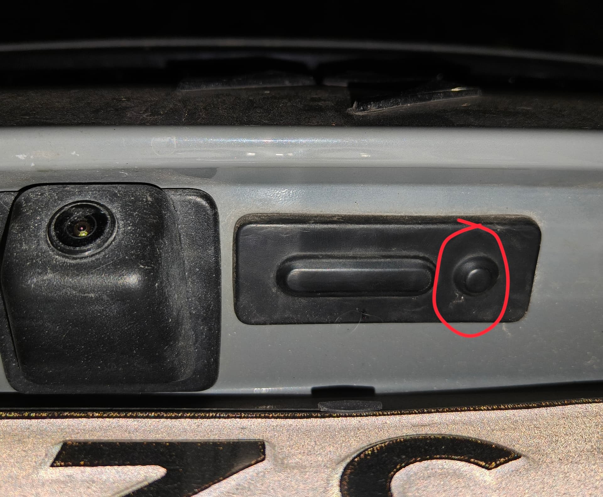

What is this trunk button for?

Hi ciquta, ive wondered myself, google ai suggests it can be pressed to lock the tailgate and doors to save you using the keyfob if you are walking away from the car. I would think you do this when youve closed the tailgate already as it would be too high to reach when in the open position. I will try it later.
I’ve tried it and I can confirm it is to lock all the doors and tailgate.

I performed several tests but no luck, does nothing under any circumstances of car open/closed and presence/absence of the fob.
Maybe you have to press it when the trunk is open?? Makes no sense.

I close the tailgate pressing the red switch, when it is fully shut press the button and it locks all the doors.
To unlock the car I just touch any door handle, to lock the car again tough any handle.
If you press unlock on the fob, press it again and keep pressed, all windows should open, to close them all do the same but this time with the lock on the fob. Hope these work for you.
I have manual tailgate and nothing happens with that button.

Don’t think my DS4 E Tense has that small button on the tailgate ?
The car has auto proximity opening & locking so perhaps that’s why.
According to the user manual, there are two options associated with this button:
Normal locking (x1 button press)
â–ş Press the handle on one of the four doors (at the markings) or the locking control on the tailgate.
It is not possible to lock the vehicle if one of the electronic keys is left inside the vehicle.

Maintaining pressure on the door handle or the tailgate control allows the windows and, depending on version, the sunroof to be closed to the desired position.

Deadlocking renders the interior door controls inoperative. It also deactivates the central locking button.

â–ş Press the handle on one of the four doors (at the markings) or the locking control on the tailgate to lock the vehicle.
â–ş Press it again within 5 seconds to deadlock the vehicle (confirmed by the temporary lighting of the direction indicators).

My note: Deadlocking isn’t standard on every car. It depends on the trim level.
Yeah, my tailgate doesnt have this small button.
I guess its because of the proximity self opening/locking that car does have.

I have this button too, it’s just to close all the doors. Same as the button on the door handles
There is an “invisible” button on each door handle that you can press to lock the car after leaving
