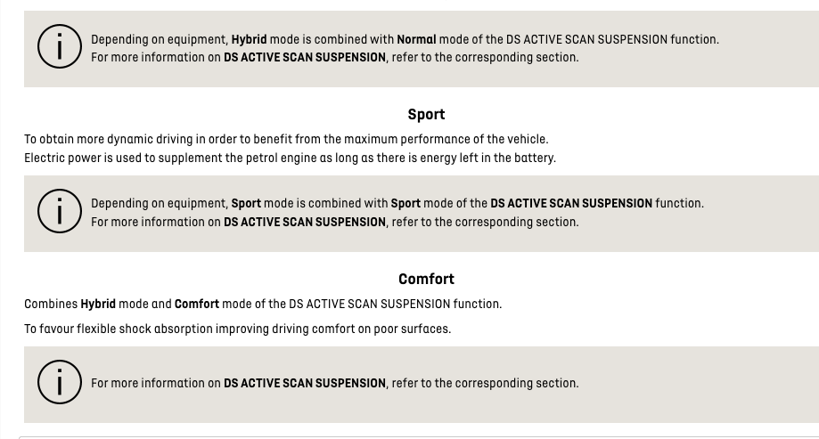

I think when the manual says:
HYBRID mode is combined with “NORMAL” mode of A.S.S, it’s basically saying the car is running with "Normal " (non active) A.S.S.
When it says :
Comfort “combines Hybrid mode and Comfort mode of A.S.S”, its saying A.S.S is now active in Comfort mode but also utilises the Hybrid side of the car.
So in reality, if you drive in Hybrid mode your already in A.S.S but it’s in NORMAL (non active) presence, switching to Comfort mode turns A.S.S on but at the same time keeps the car running with the Hybrid features.
If that makes sense. :roll_eyes:
I still cant feel any difference though.
