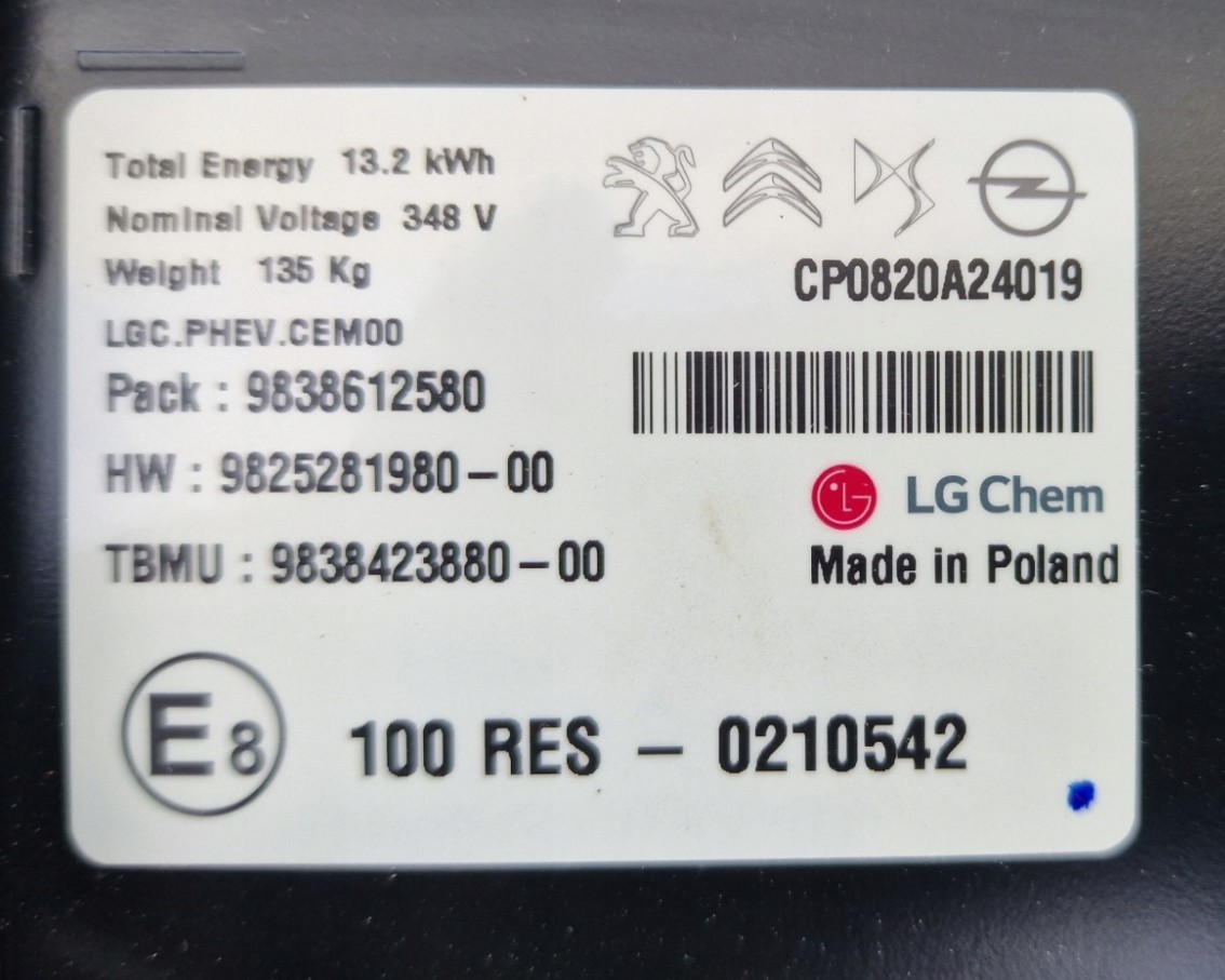

No. Yours is 12,44kWh 305V. In DS7 is 13,2kWh 348V. Both LG Chem.
Do you know who is supplier of whole battery pack?
As I wrote - LG Chem

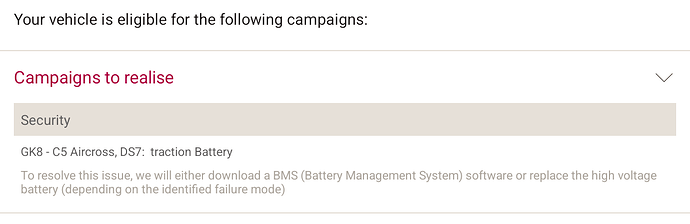

My app says nothing. But if i check the VIN for callback i get a persistent error when i try to look it up. I got the [VIN CENSORED]**** vin so i think i migjt be affected. Im based in the netherlands.

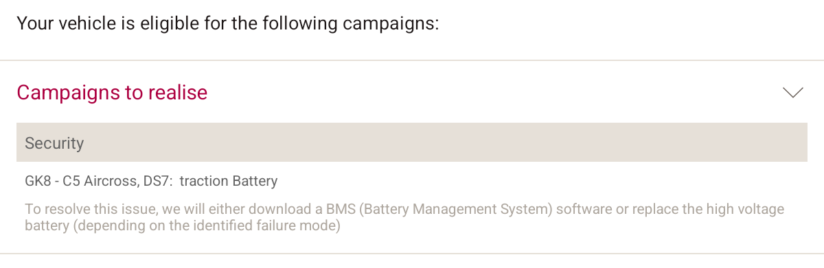

Generally they do this: To resolve this issue, we will either re-install the BMS (battery management system) software or replace the high-voltage battery (depending on the type of fault identified).
GK8 is the second recall. First one on the same topic was JQD 04/04/2023.
If they’re changing the TBMU software, I’d skip this recall. This is a potential problem for the future because it reduces the traction battery voltage tolerance. This results in an electric drive failure, and only replacing the traction battery with a new one solves the problem.
