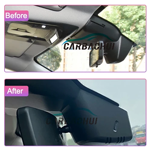

Second. You don’t touch the factory camera with this type of replacement, as it’s just a mirror housing replacement. You simply connect the new camera’s wiring harness to the mirror’s wiring.
So the existing screen camera stays in place and the new dash cam sits alongside it, using the wiring within the mirror housing.

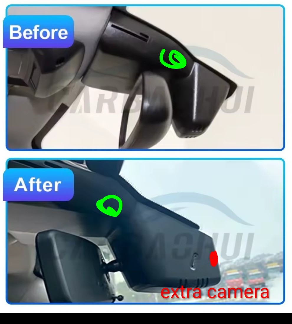

The camera you have stays (green). There’s a second new one (red) that records non-stop on a microSD card.
