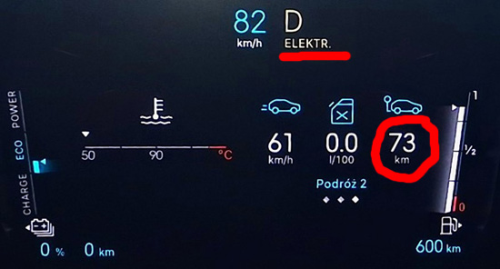

My record on electric power alone is 75 km (47 miles) on a single charge, and that was without B mode.
Is that 47 miles on the trip counter of what the electric range showed @ 100% charge.
Yes, this is the range with the traction battery fully charged and running on electric mode only.
I took this photo just before hybrid mode was activated at 75

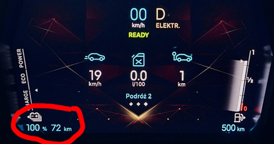

Two days later this was my theoretical range on the traction battery alone.
