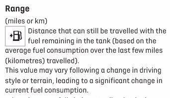

It uses the last few miles you have been driving to calculate how far you can go if you continue the same way.
So coming from urban area out on the highway, your consumption goes down, and after a while it will start adjusting and increasing the distance left until empty.
And vice versa.
Is that the explanation you were looking for?
From the manual:
