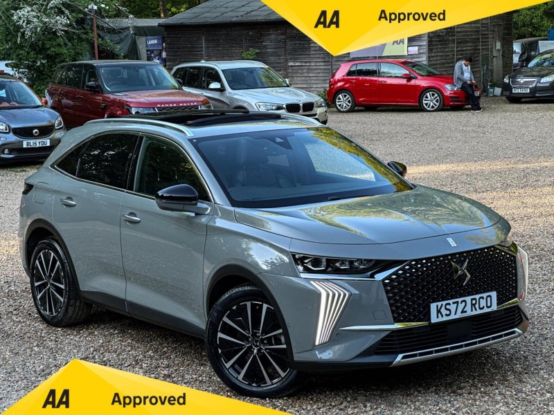

Morning all, so I have been keeping an eye for the car to re-appear on the market and low and behold it has come back up for sale this morning with the same dealer that I bought it off - Bravo Motor Cars Ltd which doesn’t surprise me.
https://www.autotrader.co.uk/car-details/202505082172212?sort=relevance&twcs=true&searchId=fe63076e-1933-4a4b-8ed2-f32447200495&make=DS%20AUTOMOBILES&model=DS%207&page=1&postcode=sa15%202dz&advertising-location=at_cars&fromsra&backLinkQueryParams=channel%3Dcars%26postcode%3Dsa15%25202dz%26make%3DDS%2520AUTOMOBILES%26model%3DDS%25207%26flrfc%3D1
On this occasion they have listed in the description it has been previously repaired but again nothing about the defects with the car such as leaking sunroof, infotainment system defaulting to French, voice command not working etc.
They have used the same images from when I purchased the vehicle, along with the same AA report from May (which is only a mechanical check but still tells the potential buyers nothing)
At this junction I am taking Bravo Motor Cars via small claims court due to them withholding part of my deposit but also they completely misrepresented the vehicle at point of sale. I have a mediation session next week but I already know they won’t settle.
Just messaging to keep this thread alive and making as much noise about KS72 RCO to try and stop someone else buying the car and being duped by them.
So infuriating that they have the cheek to put this back up. Shows the level of attention they pay to detail, when it’s advertised as a DS3 and with 20inch alloys - it only has 19-inch alloys. I’m sure it also doesn’t have the upgraded FOCAL Electra HiFi System they claim!
They are clearly trying to swerve future problems with the declaration in the sale that it has had previous repairs but not saying what these are. The whole “recommend to inspect” is ridiculous, as they know the damage won’t be found unless someone takes the interior lining out. If anyone gets a vehicle history check from VCheck, they will find all the damage details, but unfortunately the history check companies don’t share details, so that’s the only one it would show up on
