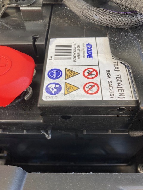

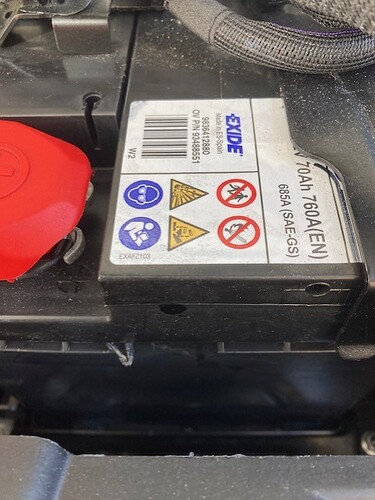

When I select 760 A & EN on my tester it shows SOH poor but if I select SAE 658 A it passes.
So I’m a bit confused .
You do not set the starting current (760A) on the tester, but what is given in Ah, at yours bat. it is 70. The results will show the real starting current.

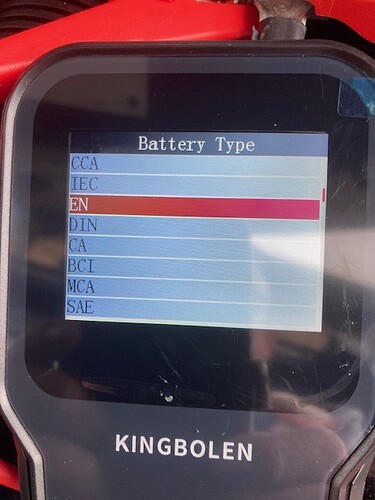

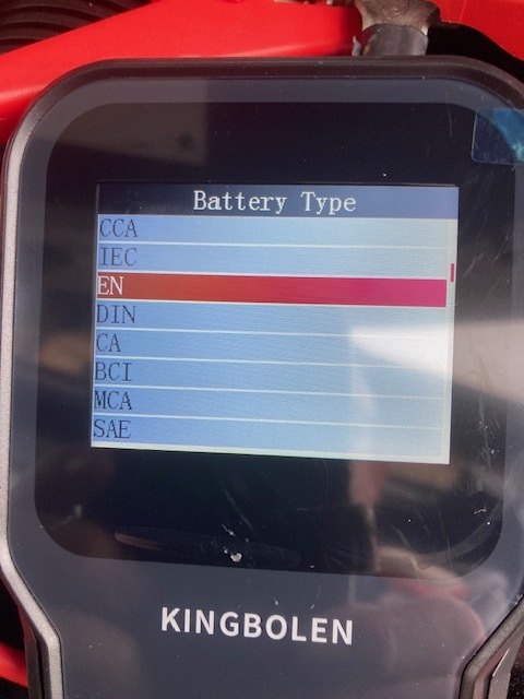

But after reading Andrews advice I think I may of been using it wrong to test the SOH.I was selecting 760A with EN , but then finding the battery failing, Andrew suggested I try 76A & EN, so I’ll give that a go and see what I get ?
So after taking Andrews advice I’ve just had another play with my tester and I’ve a feeling it may not be suitable.
Hope I’m wrong.
The lowest I can drop the battery type to is 100 EN.
Maybe Andrew can look at the photos and offer a bit more advice.

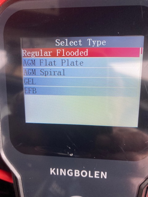

First photo:
I selected Regular and then tried EFB
Second photo, battery type, I tried EN first then CCA and also SAE.
Third photo, battery spec, 100 is the lowest I can select on the tester, with any type.

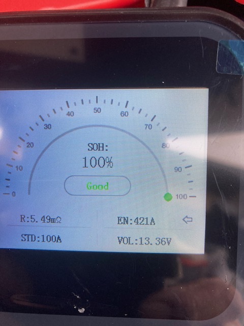

Fourth photo is results set to Regular flooded, EN, 100.
Would I be right in thinking if the tester allowed to drop the spec down to 70ah I would see a better OHM ?
CCA is the starting current. So, in Kingbolen, you set either EN or CCA and choose 760. Mine is different, and I set it to 70Ah. Sorry for the confusion.
BTW, 5.5mOhm is a very good result.

I just did an internet search for a result of 5.49OHM on a car battery and the results say the battery is dead ?
The lower the better. A bad battery has 15-20mOhm or more.
When I set EN or CCA @ 760 it comes back as a fail ?
Higher battery resistance means it is sulphated.
Not 5 ohm only 5 miliOHM. It’s x1000 difference.
Ha, so the m after the 5.49 relates as milihoms ?
