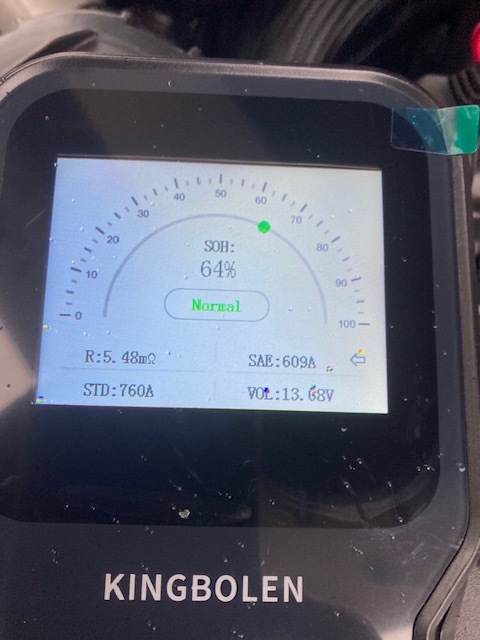

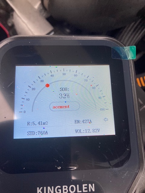

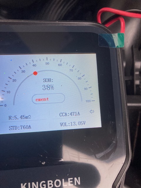

Why do you think its failing if set it to 760 EN or CCA ?
Actually out of all the choices it only passes on SAE ?
Heres the results I’m seeing with SAE, CCA & EN set at 760
I’ve tried the tester on my wifes car and I’m seeing the same results.
It passes on SAE but nothing else.

Stay with EFB EN 760
But its coming back as a SOH fail with those settings ?
I’m not sure though the battery is failing as all other readings suggest its a good battery ?
This is the 5th main 12v battery in 12 months, theres no way these can all be failing.
This one has only been on the car 10 days.
I might try disconnecting it from the car and then test it ?

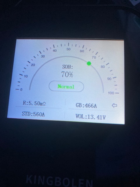

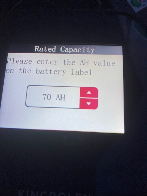

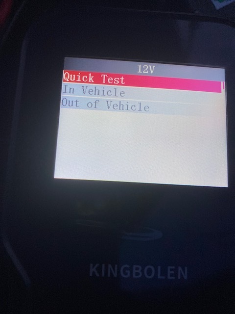

I’ve just realised theres another setting on the tester.
If I select ā€œQUICK TESTā€, theres an option to input the amps per hour.
Quick Test avoids putting in any other information.

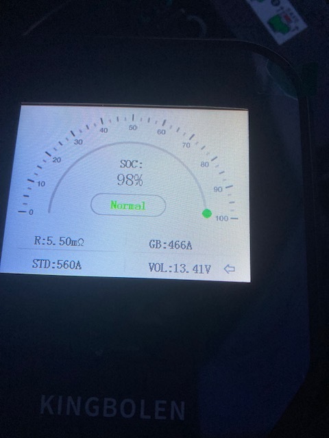

So heres the results after just using Quick Test.
Not sure if 70Ah is the correct figure to test at ?

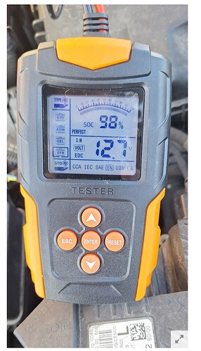

Now, that’s probably closer to the truth. But I personally struggle with yours tester because it’s not intuitive. It doesn’t have to be perfect and complicated, just good and simple.
Yes, I’m not convinced it works correctly using the more complicated settings.
@Jactac, if nothing else your helping me with my research for a user friendly tester.
@Andrew_PL Where did you get yours from, make and model?
QOLTEC 52484
Now that I know my tester can function in a more basic mode I’m happy enough with it.
it would be nice to understand the settings where you input the full spec, ie: EFB EN 760 , and why this then shows as a fail.
I’m sure theres a reasonable explanation.

I took the tester down my dads house earlier, he’s just had a new battery so tested that using the basic setting and it worked perfectly.
I then re-tried it on my wife’s car, again using the basic test and agin no issues.
So either I’m not using it correctly when in the full spec mode or it’s not liking this setting on my DS with the battery still in the car.
The basic test gives all the info you would need anyway, just like Andrews.
The more detailed info it can offer is over my head anyway, such as Wave Form & Ripple testing :face_with_spiral_eyes:
In basic test mode all you input is the battery voltage and Ah figure, it then gives two results SOC & SOH, like the photos above.

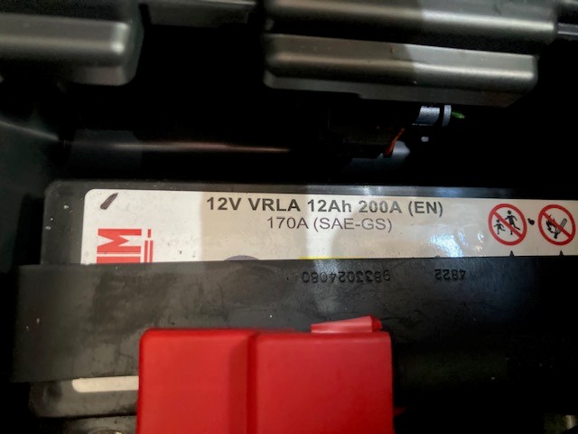

Not sure the ID or part number of the smaller battery but heres a photo of mine .
I’m sure one of the other guys will have the exact part number for you.
