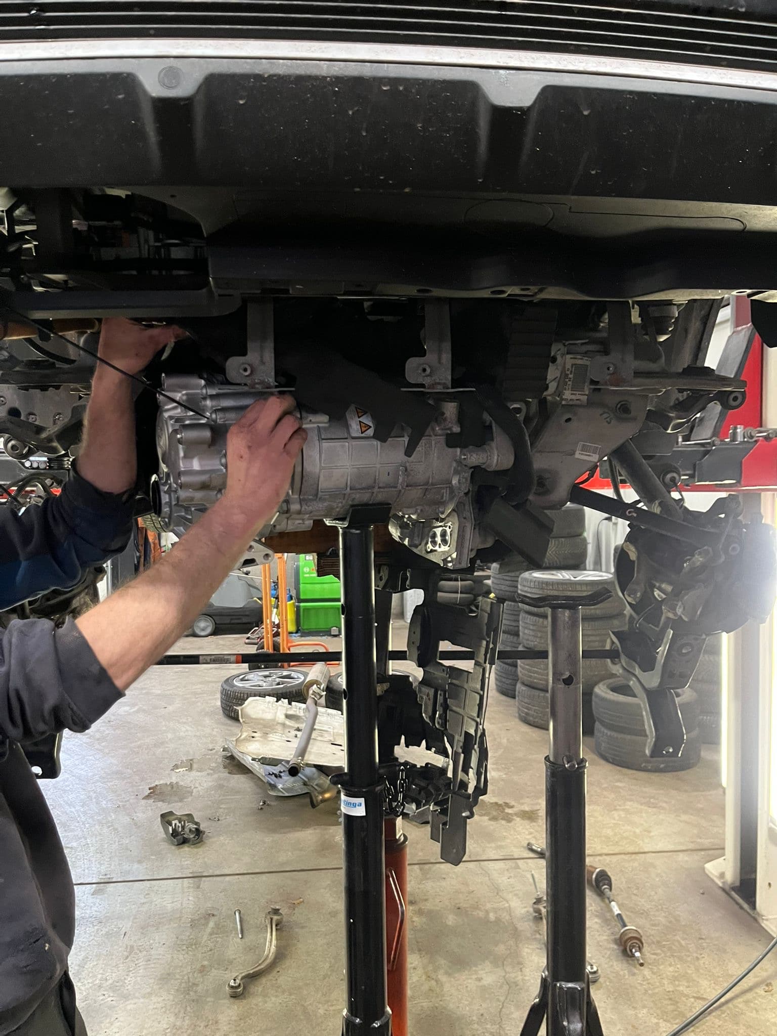

Yes. There is play in the diff and its going to be a serious job. Waiting on my insurance now, i bought a year of warranty. solution will be made clear coming days keep you posted
This is not my problem. As stated in OP
Update 2: the car needs a new differential and som cog wheels for the electric motor, the insurance has agreed bit only with a revision piece. I can understand this cause when i asked how much it wouldve been if i would have to have paid he answered north of 5000 euros…..

So diff has been swapped out the repair was ~4000 euro’s
